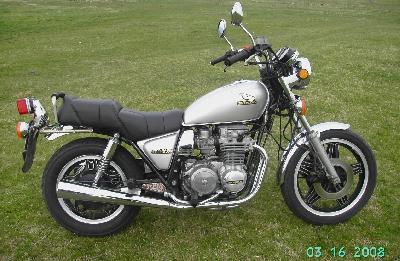

Postby eternalfrost » Sun Aug 10, 2008 3:11 pm
i sort of figured you would need a fuel injection system for an adjustible flex fuel to work.
i know for sure that besides the aluminum of the body the fuel would touch, a few inches of fuel line, plastic carb floats and a gasket in the carb.
ive taken it apart completly so know the whole system quite well.
heres a stock picture of the model i have. 1981 honda cb650

Postby HookLine » Sun Aug 10, 2008 4:02 pm
That's pretty.
